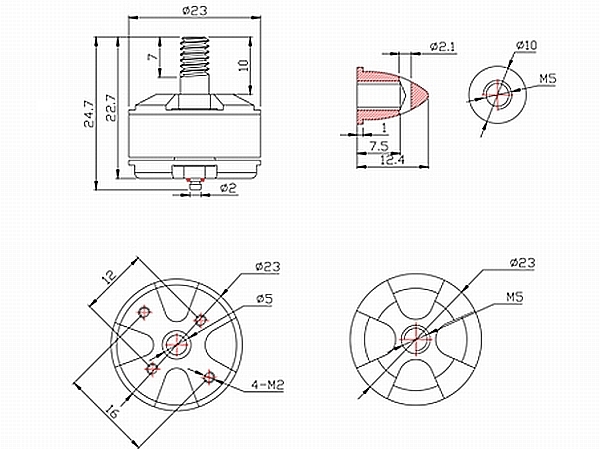

Post by Andy Sayle 2015-03-03, 13:09
Oggie, what's the outside diameter of them there DYS motors?
Same question to you barnes, but for the Emax motors?
I'm just drawing up some bumpers for the arms....

Post by Mark Barnes 2015-03-03, 14:13
23

Post by Odoubleg 2015-03-03, 14:28
Same here 23

Post by Andy Sayle 2015-03-03, 15:56
marvellous. I've done a bolt on horseshoe type bumper that is held in place by the heads of three bolts. It should hold it tightly, but not need the motor bolts to be disturbed to replace/remove.

Next job is the angled motor mount....
