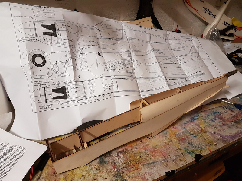

Once dry F2 is added along with the wing bearer that sits behind F4
At this point the 2 fuselage halves are joined together, making sure its all square its put to one side to dry

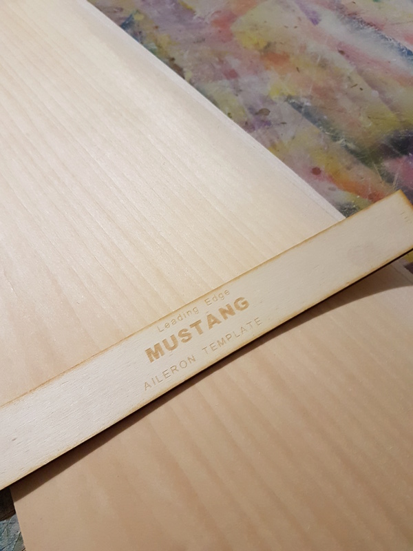

So this morning its al dry and we have a couple of panels that look like wings, Ive given them a rough shaping ready for a final finish once complete
New to the kit is a Alieron template to make making them easier,
mark out
cut out
and shape the Ali stock to fit. I do cap the ali hinge point with balsa stock to make the hinge point stronger too.
