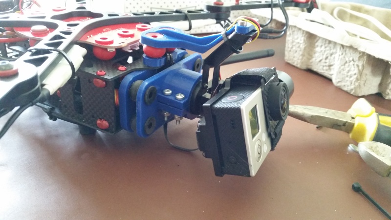

Ocer the past couple of weeks ive been putting together and sorting my new aerial picture taking device. The Imersion RC Xugong v2.
While not as cool as the phantoms and large multirotors infesting the club the Xugong has a place. Its a 450 size frame with a bit of a part peice.
Folds up to the size of a 250mm frame
Thanks to Andy S and his magic 3d printer ive been able to mount my Walkera gimbal
The Xugong come complete with iOSD and gopro charge/interface cable and video switch so you can flight betwen a fpv cam and the gopro while in flight.

That gimbal mount looks slightly over engineered with the cable tie

There is 2 bolt holes to bolt through. The cable ties aloud for quick back to back comparisons as we were not sure the vertical mount was required.

It also helped keep the gopro wire out the way. Its non structual

Having seen it in the flesh, I don't think the upper stabiliser is needed really. It was printed in case the gimbal suffered from nodding in flight. Normally the gimbal is suspended under the damping plate. In this application it is hanging in front....
