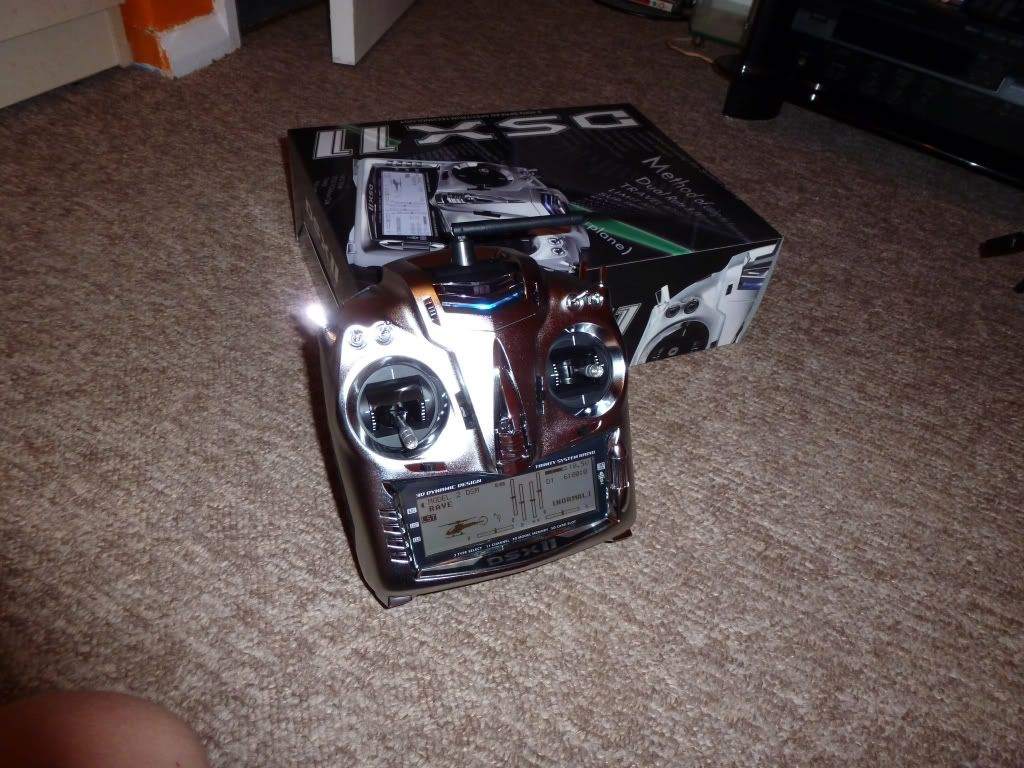

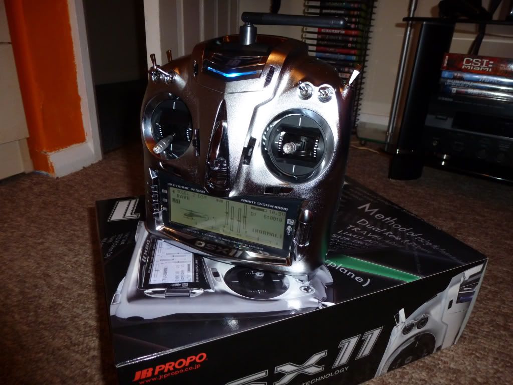

After over a year of trying to decide which radio to go for,I finally picked one up.
I fancied the DSX11 for a while but wasn't sure on the looks,I'm still not sure really.Its like a bag of twiglets.Open a bag and the first few you think,"that's quite nice.Hang on,no its not.oh maybe it is" and at the end of the bag you're still undecided.
Anyway thought I'd share a little review about what I've found over the last few hours poking around in the menu.
First up is the feel of picking it up.when you pick up the DSX9 the 2 bumps on the back where you're hands wrap around give you a confident grip,and even without a neck strap you feel that you can hold it without the fear of dropping it.
The DSX11 has a very shallow and smooth back,and as soon as I unboxed it I felt like it would be easy to drop.Not a problem with a neck strap,but I won't be using it without one.
When first switched on you are greeted with a bright sharp screen and a blue light.(always good)
A good wiggle of the sticks reveal some very smooth action,noticeably smoother than the 9.
In the menu there is 3 pages to flick through,with the usual suspects in the first 2 pages,
Dual rates and expo,
Travel adjust,
Limit adjust,(haven't quite figured out the point of this yet)
Sub trim,
Reverse,
Servo speed,(for slowing the servos if you wish)
Throttle curve,
Pitch curve,
Tail curve,(not really needed with current gyros)
Throttle hold,
Swash mix,(lots of options with all the current ccpm mixes,and a few I didn't know existed)
Trim system,
Throttle trim,
Program mixes 1 to 6,
Mix-throttle,
Flight mode delay,
Stick position mix,
Timer,(can be activated in many ways and tied into any switch)
Mix monitor,
Monitor.
System list is,
Model select,
Copy/erase,
Type select,
Model name,
Flight mode name,
Warning,
Tx settings,
All servo hold,
Trainer,
Devise select,
Swash type,
Stick mode,
Throttle stick direction.
All switches are in the perfect place if you've got suitably large hands,but people with little hands might feel its a bit of a stretch in places.
For example,the sticks actual travel limits actually travel a few mm more than the Spektrum sets and previous jr sets.If you look at the throttles notches you line up the furthest one at full throttle and can travel a little more.
I tried my old set next to the 11 and it is a bit trickier to reach the limits without altering you're grip.
Jr apparently will tweak it for you and re calibrate the throws if you wish for around £50.
All I'm going to do is shorten the sticks.
Something worth noting with setting up a heli is the throttle and pitch curves is that when you first go into them,they are only 3 point curves.Moving the throttle to 25% or 75% travel allows you to press add,and it allows you to use 5 point curves.The dsx9 allows 7 point curves if you like that kind of adjustment,but the 11 sticks with 5 points.
It comes with a 1500mah nimh pack which I'll be changing to eneloop's and hidden behind the battery is the sd card slot for expanding model memories if you need more than the standard 30 model memory,and it also allows you to download updates as extra features become available.
The build quality is very good,and the plastic case feels of good quality and is surprisingly light for its size.
Overall it's a very nice set and is a bit of a bargain for what you get.
Here's a couple of pics.
I can't comment on the plane and glider menus as they are straight over my head but I'm sure Zaide could add some bits,if he's actually read the instructions that is. Suspect
